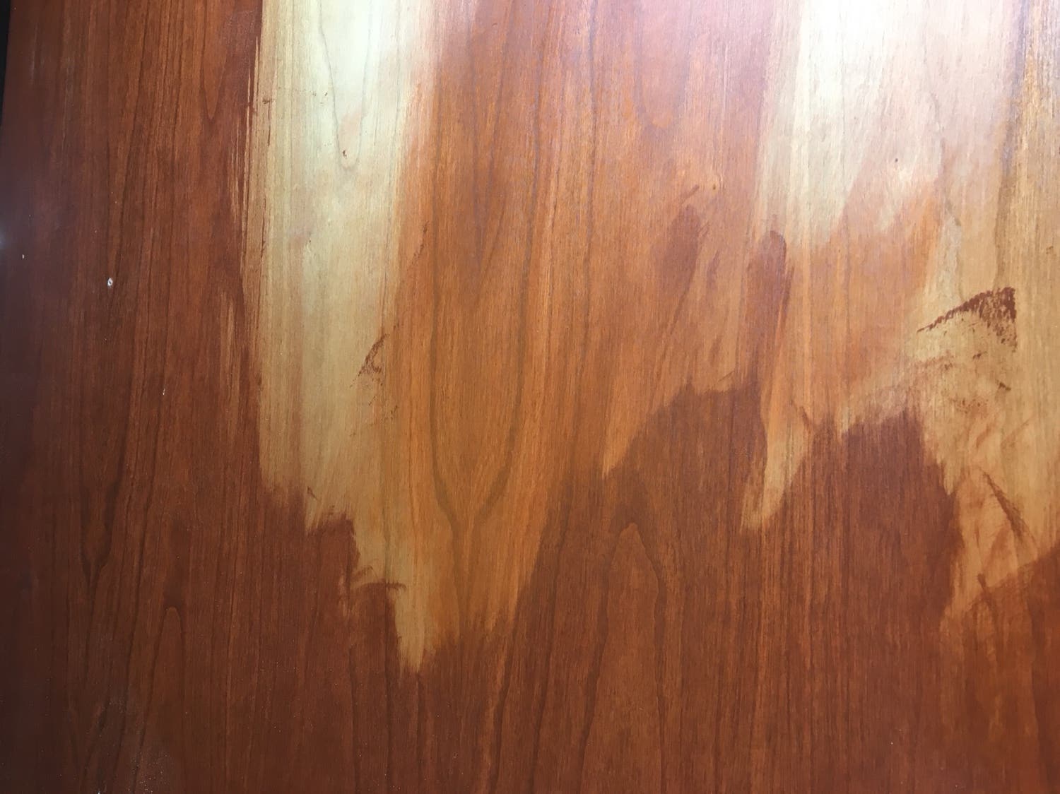

Well what I've got going on is an area of water damage on the bottom of the side panel of the refrigerator cabinet. It's a custom cabinet, glued and clamped together so no good way to take it apart.
The plan is to do a dutchman repair on the bottom of the panel, veneer both sides, then stain and finish both sides.
The part that is pictured is the area of the side panel that met the base cabinets and they just didn't stain and finish that portion so I thought I'd try some samples on there.
I called SW today and they will match the stain for me. That is the route I will be going. As much fun as it would be to play chemist, I'm not going to pretend that's a skill I have and I'm not gonna waste money trying to acquire it right now.
The problem with matching by eye is not everyone sees colors the same way. Also, unless the actual tint material is the same in the original stain and the stain you are using, you may have an exact match in daylight or under LEDs, but not with some CFLs. Some CFLs put out relatively string light in orange bands, and little either side if them.
I've seen it a problem with paint, but haven't noticed it yet on stains I've used .
Sw matched a stain for me recently. It was perfect. Then I ran out. And the "code" they made for the original was nowhere near the same color when they made the second batch.
My store manager came out to the site with a bunch of tints and nailed it by hand.
