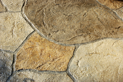

My take is it is something like this:
Over something like this:
I consider that Faux finish or stamped concrete...I dont do any of that, only pressed or wet cast counter tops and sinks.
