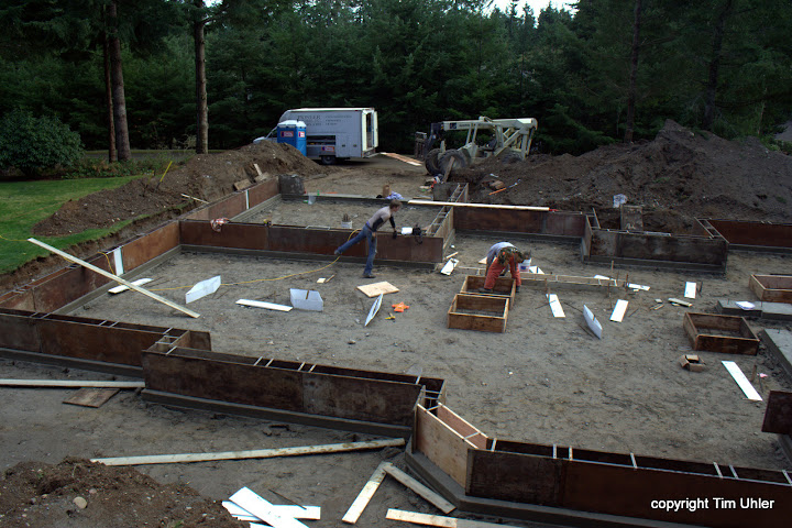

Work has been slow this year, but we signed up a custom last week, and set up footings today. We've got a little work ahead of us so we hired Kyle back
It has been super soggy here the last week or so and today we got a nice break. Sunshine all day and made good time on the footing.
We started forming around 9am (after finding all the foundation gear and getting to the jobsite) and left at about 2:30 with it ready for inspection. Just 2 of us until the last hour then my brother showed up and tied some bar.
We are scheduled to pour at 1pm tomorrow if we pass inspection. Pictures are here http://picasaweb.google.com/TimothyU...ot25Gleneagle#
We've built this house one time before http://picasaweb.google.com/TimothyU...ot46Gleneagle# but didn't build the foundation the first time.
I'm super excited to frame something. I also met with the ILevel rep yesterday and they want us to try their new Shear Brace http://www.ilevel.com/walls/w_Shear-Brace.aspx on either side of the garage and are giving us the 2 walls to try out.
Even though it is not the greatest time of the year here to be framing, I'm very excited about it. I think we may also use the Zip System again. After a very rough number crunch it is close to a wash for materials for using the roof and walls. We were about $400 more expensive using Zip on the last one, but I haven't factored in the roofers price, nor have I figured my labor hours yet. So we'll see.
More pictures to follow in the coming weeks

looks a little wavy tim
seriously though, are the footing just laying on grade or is the picture deceiving?

What that is is the forms offsetting at the laps. Although I should check it, I didn't level that side and didn't think to check Kyle's work.
The footings are raised off the dirt to give it a depth at the min 8". We have the grade sloped and put a pipe under the footing at the lowest point so that if the crawlspace gets water in it, it'll drain and not just sit there.
I cropped the picture to show the footing. I took it before it was brought up to grade. The form isn't totally nailed together until after it is brought up. I put a stake next to the single nail in the overlap, it acts like a pivot. After the forms are levelled, then the lap is nailed tight.
If I get a chance I'll get a better picture tomorrow.

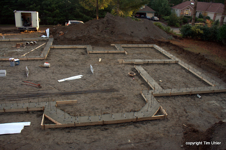

Passed inspection, poured the footings from 1-2pm and then snapped it all out and set clips. Ready for forming the walls tomorrow and it'll be raining on us
http://picasaweb.google.com/TimothyU...71065509439346

dirt don't freeze in WA?

Not where we are. No frost heave. I'd have to look it up but we dip into the upper 20's a few times a winter. Avg lost temp is mid 30's and highs mid 40's. Pretty moderate.

i'm so used to everything being dug in that something laying right on grade looks waaaay odd to me

Looks good Tim. I think we'll get away from the block and try one of these formed and poured foundations on our next spec house. I checked out some of your pours in your image gallery, and you guys make it look too easy.

It isn't that hard. It is more difficult on stepped lots and basements. I'll hopefully get shots forming the walls tomorrow, depending on the rain. But get your footing square, or pretty close, then snap your lines for the walls as square and parallel as you would framing, then just plumb the corners and brace long runs if it needs it and that's it.
The hardest work is stripping the forms That is not always (ever?) fun.
I'll try and get good enough pictures that you can figure out the process.

You guys need to relax about the footing depth and soil conditions. I used to live close to where Tim lives and this is absolutely the norm there. Actually it looks like he has some sand down which is a luxury compared to what I had which was what we called walking in baby ****.
Just like Tim said, there is no frost line. Pretty much the whole west coast has no frost line.
Soil conditions in the Pacific NW are clay. You dig down and anywhere from 2' to 8', you hit hardpan which is like hitting ledge. You cannot move it, but it still gets slick when it rains.
Place a piece of plywood on a juicy muddy spot for a week and it will be quite solid when you take it up.
We backfilled with the excavation many times. What a mess if it rained alot. You'd walk along and not have a clue that a sinkhole was right there.
And garage slabs on compacted backfill.
There was hardly any type of gravel pit what you think of. They had pits, but it was more for crushed stone, blasting into the cascade mountains, etc. Not much plain ol' gravel you dig and find.
Tim, that foundation looks nice. We used to use those crappy cardboard boxes from the concrete company. Some of the worst working conditions I've been in working a hole in the winter. What misery. Mud. Rain. Get me to first floor ply.
