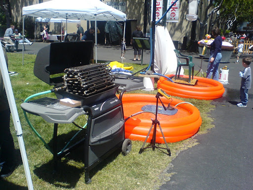

Yeah you def wouldnt want to run your water from the primary heating system through the hot tub as an extra zone. You could if you run it trough a heat exchanger which is what i guess it is already doing? Never seen one but im interested to see how they work.
I see this the other day though. Seems like an expsensive way to heat pool water to me lol

The system is working. Hot water from 4 ft. below ground circulates from my boiler,
and also adds a 350 gal. of storage water.
I used a tempering valve to control the temperature and I
can use wood or oil to heat with while the hot tub stays at 101 and
has independent loop.
