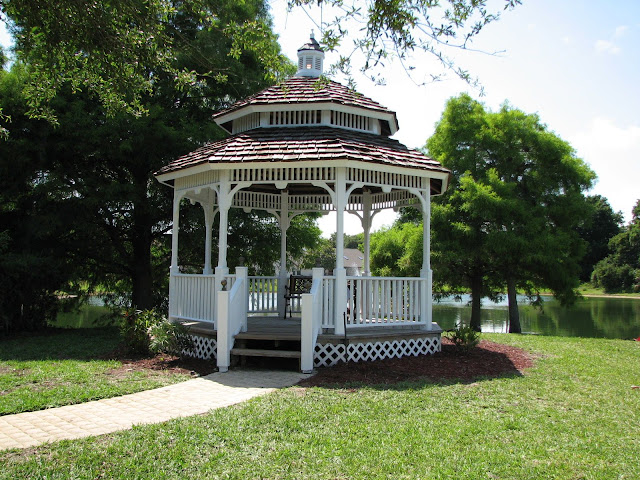

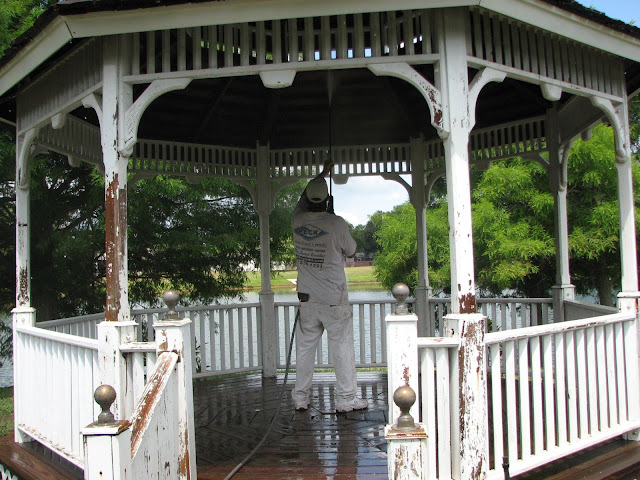

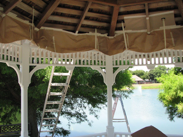

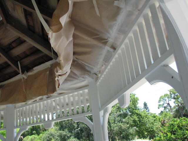

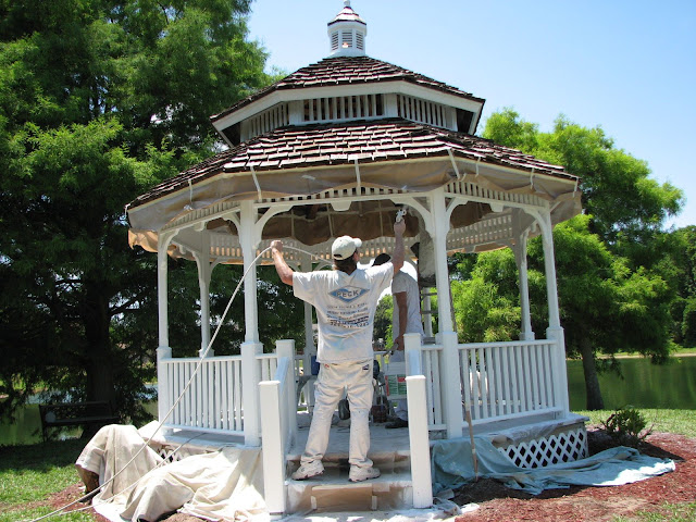

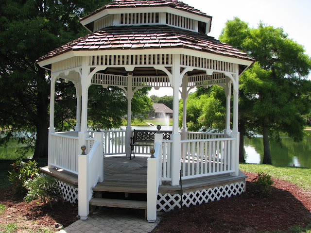

Edit: Didn't realize this thread was a year and a half old. Doh!
Greg, I would spray it forsure. Like nEighter said, small tip with low pressure.
Here's a gazebo repaint we did recently.
Had to protect the wood ceiling, shingles, and deck.
