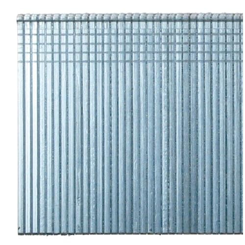

Glue and SS finish nails. Quick and clean. Haven't heard anything yet, but maybe they're too mad at me!
Perhaps I'm not understanding your post correctly...by finish nails do you mean these?
http://ec1.images-amazon.com/images/...1L._SS500_.jpg
Mac

Well, yeah, close, Stainless steel finish nails. 15 ga. angle for my senco. We use a construction adhesive here specifically for this purpose. We use it for the mahogany/ipe decking. Haven't tried it on Trex type stuff. I'll see if I can find the exact adhesive. We used it this winter in 0° weather and it came out pretty smooth without heating it. Not regular construction adhesive.
Glue it down just like subfloor and nail it off. No squeaks.
