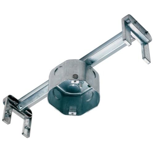

I have a sheet metal ceiling that I need to secure 7 boxes for 7 pendant light fixtures over a bar. The floor joists supporting the ceiling are 16" oc but they won't help me because of a pattern in the sheet metal. The ceiling dates back to when the bar first opened in 1934 and I want to do a good job to preserve the old ceiling since its owner is spending thousands to have it repaired in certain areas. I am open to suggestions on how to go about doing this one.

You'll probably have to use those old work fan box kits with the bar line Reiker makes, that you work up through the light hole in the ceiling, for the lights and the fans. Expensive way to go, but the only choice, as I see it. I guess you have one of those pressed tin ceilings, and the light holes need to fall in a certain place in the tin pattern? Yeah, I've done maybe one or two of then. Run your hole saw backwards until you get a nice line scored in the tin, so that it doesn't grab it and rip you off the ladder. http://www.passandseymour.com/litera.../49163_PnS.pdf

Just thought I should add that none of the old work ceiling boxes with the "wings" are rated for fixture support. You need to independently support the fixture from the box if you use an old work ceiling box with wings. Impossible if you're using a fixture with a 4 or 5 inch canopy (which is what your pendants will likely be), which puts you in the position of having to use the Reiker fan kit.

The original idea was do use conduit. But the wires could be fished. The problem is with the boxes and of course the support. The fixtures are some crap from Lowes and weigh less than 25lbs. I was thinking of independently supporting the fixtures by way of ridgid conduit secured to the joists by maybe threaded rod, and use cords from the pendant to a single receptacle mounted in/ on the ceiling. The ridgid would sit something like 6-12" below the ceiling so that only the weight of the receptacle would actually need to be supported by the actual ceiling.

First let me apologize for not taking and then not posting pictures like I said I would. Sheet happens. But long story short, the lights came out good. I used 3/16" toggle bolts to support 4" round metal boxes for the pendant lights, and for the fans I used ceiling fan rated 4" round boxes secured directly to the floor joist. The job came out well and I should be going back this week or next to finish up some punchlist stuff.
