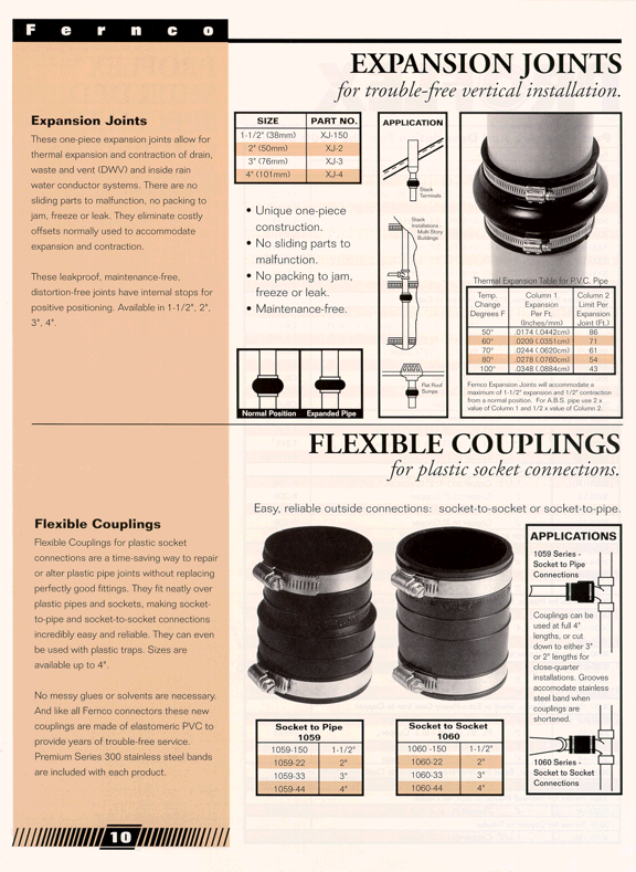

Re: Remodel Basement
Originally Posted by Greg Di
All your plumbing connections from water heater, boiler, etc would fail if they were roller coastering on a slab moving like that. Your basement staircase would crack in half too..
Flex copper lines get sweated in at the ceiling level for hot and cold lines. (Installing Pex would be helpful in these situations too I suppose.)
Fernco expansion joints and rubber couplings are used on the drains and vents.
I should add, all of this is reason enough why a lot of builders for basements are doing wood subfloors that are fasted into the basement walls 18 inches above bottom grade instead of doing slabs in the basements. But when you are talking remodeling on a slab sometimes this is what needs to be done.
