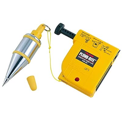

If you do decide to tackle these, forget the level for plumbing them. Use a plumb bob and measure to the side jambs. Goes so much faster.
Now, as for how you fasten them once they are plumb? Beats me, I've never installed one that wasn't roughed-in in wood or metal stud framing.
