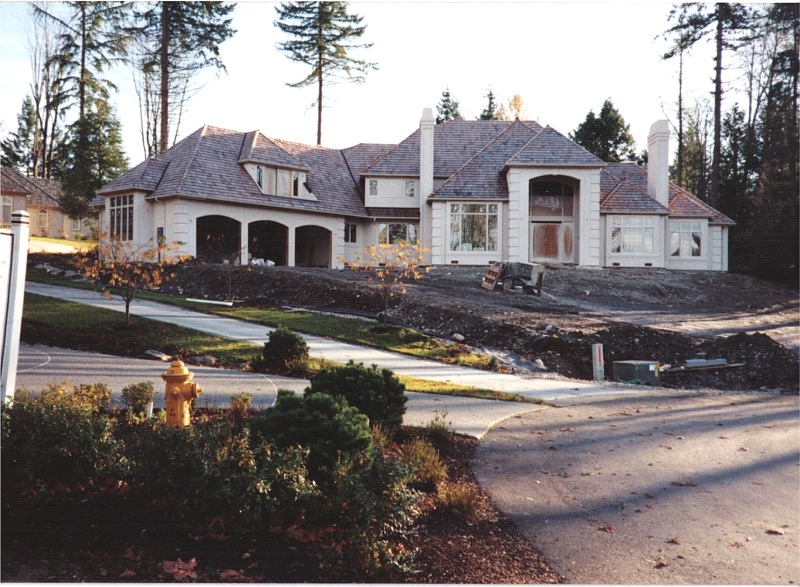

Definitely use a frieze board, if you are going to the expense of shingled gables don't cheap out.

I think shocker was talking about a frieeze board against the soffit, not a horizontal band.
It's better to die on your feet than to be living on your knees.
jumbo is offline
Old 08-22-2009, 10:15 AM   #10
Sophisticated Siding Guy.
thesidingpro's Avatar
Trade: Siding and Trim Specialist
Posts: 259
Re: Questions About Hardie Shingles
Yea using my terms I don't see a frieze board on that house. Someone went cheap.

Maybe it is the angle of the picture, but it is there. See enlargement.

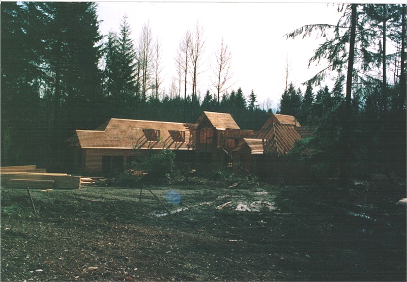

I think there is a frieze board on this one too. This pic has a better angle.

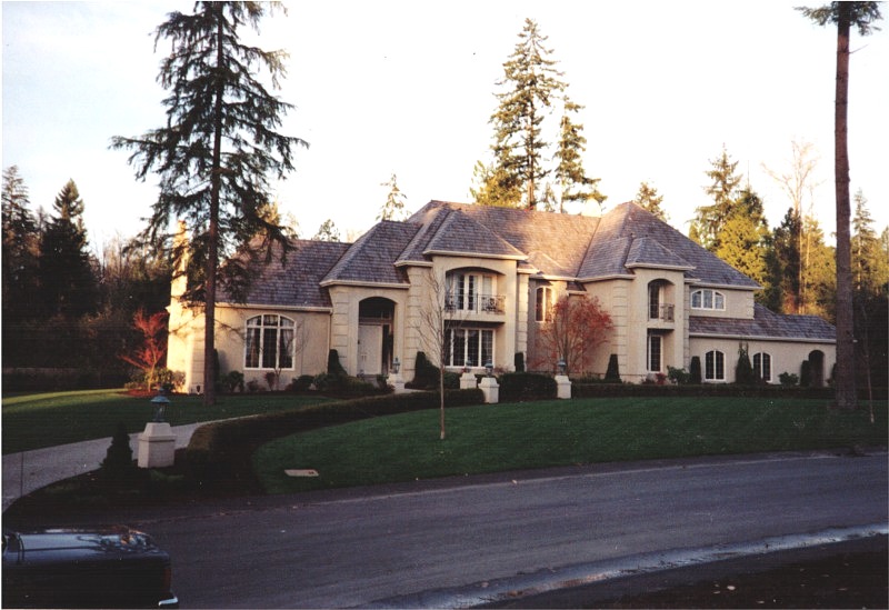

This pic is not that great, scan from a pic from cheap camera in 1990. But a better angle to see the frieze board.

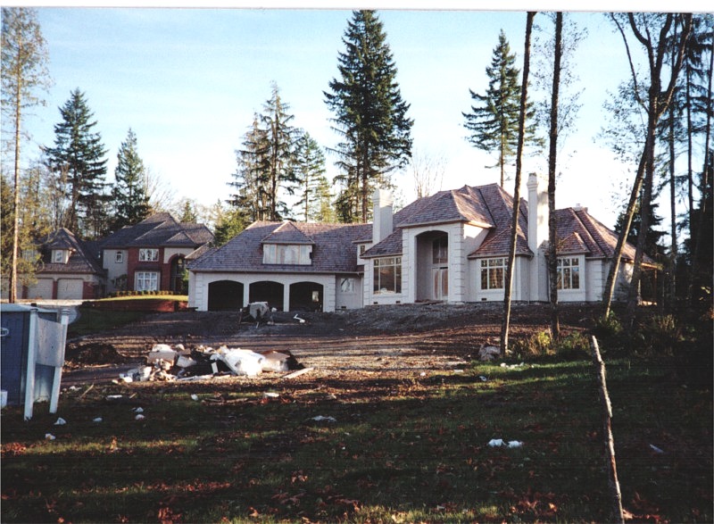

More pics from 1989-1990.
I think I know what a frieze board is or at least what they call it around here, since this is what I was building 20 years ago. A frieze board around here is the board flat on the wall under the rafter tails or under the rake of a gable up against the soffit and flat on the wall, and which the siding butts up to.

Found a pic of the next to last house under construction I posted earlier, finished.
