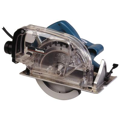

Makita 5057KB saw with dust collection
I have only used the saw once since I can do just about everything with the shears. But will be using it with the Nichiha siding and the new Hardie Artisan since they are too thick for the shears.
