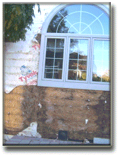

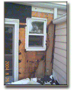

Proside
But and Caulk on the vertical is a good and sound installation. A true watertable at the top of the window sheds water. J Channel by contrast, even if you cover it with aluminum, will leak. It collects water and sends it under the siding. The problem with the industry is the belief in a "System." It has diminished good and sound reason in the field. A leak to the underlayment is a leak, plain and simple. Just like anything else, your weakest link is the measure of the total strength of your system.
So your siding is your housewrap, or underlayment. Your protection system for the houswrap is your siding, the "Supplemental Rain Screen," Vinyl Siding.

Re: Closing Up Shop
Hey lost, first of all the pic on the right looks like the leak was caused from the gutter and second, no sh*t J-channel will leak IF YOU DON'T INSTALL IT RIGHT. Once again it isn't the siding or the horrible J-channel its the idiots that install it wrong that are to blame. GET A LIFE, LOST
