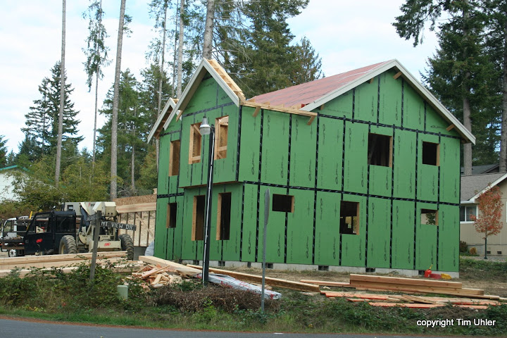

Advantech is the best subfloor hands down. We've used it many times and will use it again on the custom we are starting Monday. It isn't cheap though. We'll pay about $21 and change/sheet and the subfloor we have also had good success with (LP Orange) is about $14/sheet.
If you have not used Advantech before, you can get a rebate up to $900. Check out their website for more details.
The Huber rep came out to our jobsite a couple of weeks back and went over some of the info on Zip and Advantech. The subfloor has a 300 day no sanding guarantee
One point that might help mitigate the cost of the subfloor (for us it is a $750 upgrade) we always come back right before carpet and screw down the floor to minimize the potential for squeaks. With the nailing guide on the Advantech, I find that we miss very few nails and the floor is nice and squeak free. Use a decent ring or screw shank nail (.113" diameter) and I think we might be able to eliminate the step of coming back. That combined with the no swelling and the subfloor doesn't absorb moisture like OSB and Ply means that we have less time with dehumidifiers on the jobsite.
We had one house 2 years ago that we had 3 dehumidifiers going for about a month to get the moisture content down. That was not cheap. But it worked, the moisture was way down by the time we had framing inspection.
On that job we used the LP Orange and it performed just fine, but that was with the dehumidifiers going.
We used Zip http://www.zipsystem.com/on our last project and loved it. Absolutely loved it. We'll do it again on this job we are starting.

We don't use anything over the Zip, but on the roof 4-12 and under need felt.
Evergreen ordered it in for us, we are getting it through Arrow in Port Orchard on the house we just started and the rep told me that Kingston stocks it.
What caused the mold on those houses? Was the detailing done right? Was there ventilation in the houses?
One thing I really like about the Zip panels and the Advantech is that they don't absorb moisture. They are very dense. We sheathed a floor in Advantech today and I'm going to take some scraps tomorrow and put them in water and photograph them every week or once a month or so. I'm a big believer in the product.
The Zip tape is a special tape too, its not like anything I've used before. The rep told me it is the stickiest stuff on the market. I'd have to agree. We left some in the rain and assumed it wouldn't work and it was just fine.
Email me in a couple of weeks or next week and hopefully we'll have enough up that you can come by and take a look. We just started one in McCormick Woods

What I'd love to do, but it just isn't in the cards in this economy, is to use Zip for walls, tape the seams and nail battens to the walls while the wall is down. Then come back and side. I think we could get a lot of the rainscreen details done with the wall flat.
Below is the wall we finished up before calling it a day. We'll add the closed soffit framing and the soffits. I'll wait on the fascia because I can correct quite a bit of mistake in ciphering if I hang it after the rafters are in.
Do you know who originally built those houses? How old are they?
