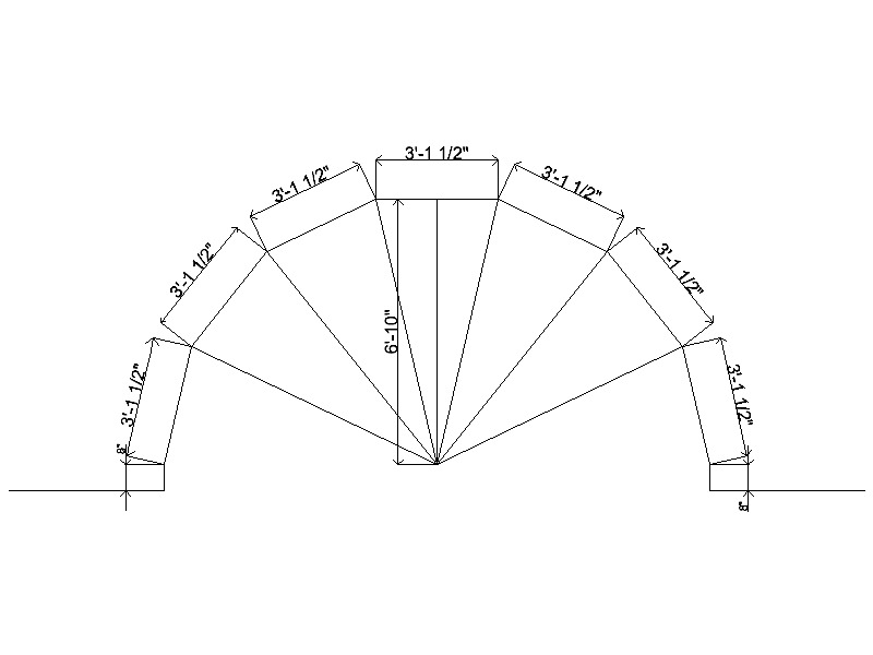

Re: Help Figuring Sides Of An Octagon
This is half of 14 sides and for it to work you don't count the 8" walls, 7 feet to each point.
It fits your specs except for the outer wall that is parallel to the building will not be 7', it will be 6'10". Will not work with a 7' parallel wall and be perfect.
PDF here
O.K.....Someone owes Wallmaxx some money...
Thanks guys! thats exactly what I had in mind
I stand corrected, Wallmax, - - I should have drawn it out on paper in the first place, - - I used the formula for 16 sides, - - mistakingly allowing those two 8"ers to confuse me into thinking they, too, were 'chords', - - anyway . . .
