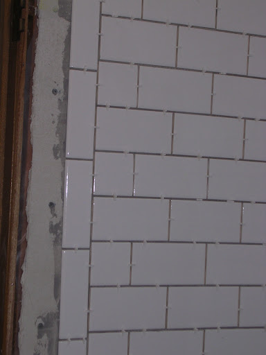

bathroom help-032.jpgHere is a picture of the wall i am talking about. If this helps to see what im talking about. Keep in mind that i am standing in the other doorway that matches this one. And room is redrywalled except bump out and tile backer portion.

Attachment 15064Here is a picture of the wall i am talking about. If this helps to see what im talking about. Keep in mind that i am standing in the other doorway that matches this one. And room is redrywalled except bump out and tile backer portion.
I agree with Forry. If you don't move your door it will look cobbled together and that is the way it is. As far as building it out the 2" on the service side only, you'll have to vizualize how your going to finish it off before closing it in. As in every remodel it's only going to increase the house value to do it right. From what I can see there is no easy way out.

I also agree with Forry- I would shim out that whole side in the picture 2" & go with a 30" door which you will also have to build out the jambs. If you do it on the service side you would have to modify all the plumbing................ Mike
Also you are not really losing any useable space as the doorway & tub take up the end space anyway.

Why dont you bring it out an 1" on each side, tile the surround and use some sink edge tiles to run up the walls over you 1" lip on each side. That would make it look really built in. Oh, I would still move the doors over a bit.

Your situation is very common on houses the age of yours, simply do what you are saying the 2 inch bump out. Don't drywall it, wrap the tile around the outside corner and end it in the corner.

In old homes with tiny bathrooms, there is still the sink and toilet which will be fighting for room, trying to gain 2 inches of floor space could be a big difference in the enjoyment of the bathroom, let alone giving up 2 inches of floor space to avoid a return on a tub by firring the wall, could sometimes be the difference in function and usability, as he already stated he's fighting for room even for the doorway right now.
So I guess I'm not sure why it looks like ass because it is only 2-3 inch return? What is the measurement that it stops looking like ass? What if it's a 5 inch return? 8 inch return or a 4 foot return? Any wall next to a tub is bad?
Running some tile wainscoting along that wall to the right will go a long way in enhancing the design and making the return become part of the design.
My point is mostly toward his question in regard to treating the tile on that return. Wrapping it and ending in the corner will look better than stoping at the outside corner of the return.

I was thinking along the lines of Mike's solution but I would pack both walls out an inch, the equal returns should make it look intentional.

Mike you are right on the money as what i am trying to do with it. Except my bumpout will be flip flopped but your sketch is dead on.. Another thought of mine is on the bumpout side is framing out for a wall shelf, built into the stud cavity for shampoo bottles and such. What king of corner do you normally put on that return?

bullnose tiles need to be used on the bump out to cover the the field tiles. Could also just drywall return the bump out and leave off the bullnose tiles.

Just bullnose if it's ceramic or porcelain. Bullnose tile is for outside corners of any kind.

thanks i just wasnt sure if they made some sort of L that i was not aware of.
