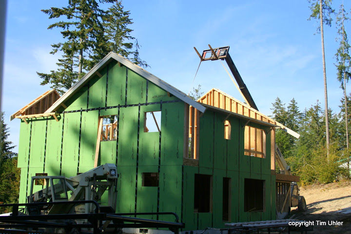

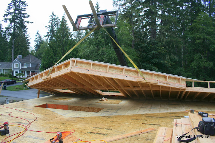

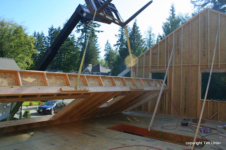

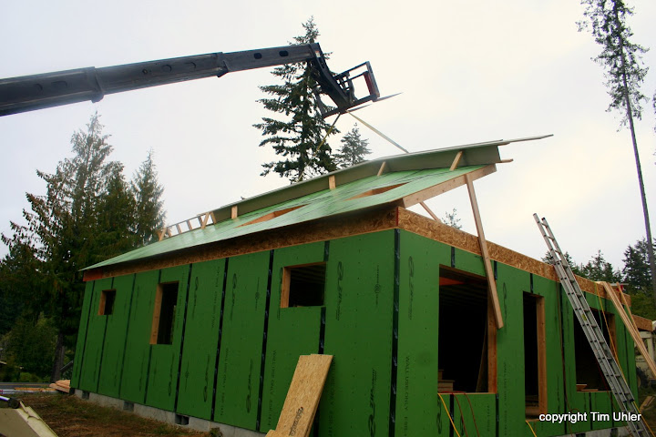

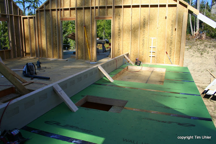

My brother and I started framing a new one 2 weeks ago. Here is a link to the progress pics to far http://picasaweb.google.com/TimothyU...eat=directlink
I love the Zip. You sheathe the wall like normal, and it takes almost no time to tape the seams. I'll add up the total when we get done that we paid and the total for OSB and Tyvek, and then see what our labor is.
You know one thing to that has to be figured is that to get the warranty from Tyvek, you have to do a lot of work to the WRB. I bet most of us don't detail Tyvek or similar as well as we could, we just blast it on.
So if you compared Zip to Tyvek installed to their spec's, I'm thinking this is a more compelling product than I first thought. Add to that being dried in, and I'm hearing from other guys that run blower door tests that you the house is very tight using this stuff.
So add the energy efficiency into the mix too as a marketing tool . . . .
