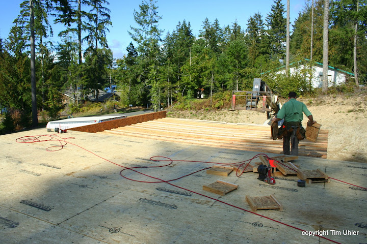

Old 10-27-2009, 06:33 PM   #27
Posts: 711
Re: Tgi Framing
The house we just finished framing has 14" I-joists over the garage 16" oc. There is a bonus room above. The garage is 22' deep (which the I-joists span) and we added a 2' cant out the back, so the joists are 24' long.
There is very little discernable vibration and once furntiture is in and the drywall is on the underside, I bet no one notices it.
Timuhler is offline

Old 10-27-2009, 06:41 PM   #29
Posts: 711
Re: Tgi Framing
Originally Posted by scottalan View Post
Have you actually had problems with people using your pictures?,whats the deal with the copyright.
I personally have had no problem that I know of, but I know some who have had problems. One of the updates to Picasa allowed a watermark.
whats the deal with the question?
Timuhler is offline
