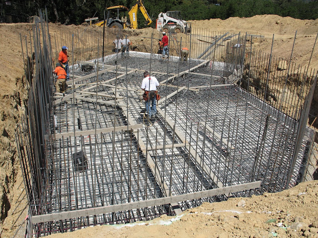

You guys want to see hardware, check out this link This is the carp I took the eyebrow class with.
Very cool to watch the progress
