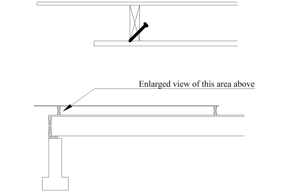

We sheath almost all walls on the floor and the sheathing is long to cover the rim, except for garage walls.
Here is how we keep it from sliding, been doing this for 30 years. We toe nail from the inside of wall through the bottom plate at a 45 degree angle. The nail will come out into the floor right at the corner of bottom plate at the floor, right on the chalk line. This way the wall will not slide and when you tip it up it is already locked to the line. And you don't have to remove the nails afterward.
Kind of hard to explain. I'll draw a quick pic of it.
I would appreciate the drawing this sounds good
scottalan is offline   Reply With Quote

Here is the drawing.
We do this when lifting standard walls with wall jacks. Really tall walls we use our boom truck.
Also don't forget to set these nails before you sheath. We usually nail this off about every other or third stud bay after we get the frame nailed off. Then we nail it to the line, and then square up the frame, and then sheath. This way the bottom plate is nailed straight to the chalk line.

We do it that way too on "most" walls. My other method is for the huge deadly ones. Toe nails can only take so much force, not to mention that soft wood is very prone to split.

we always toe nail like the pic above. biggest wall to date was 60' with no problems with sliding. (knock on wood) the lumber strap idea sound good too! I also run the sheathing past the bottom plate.
