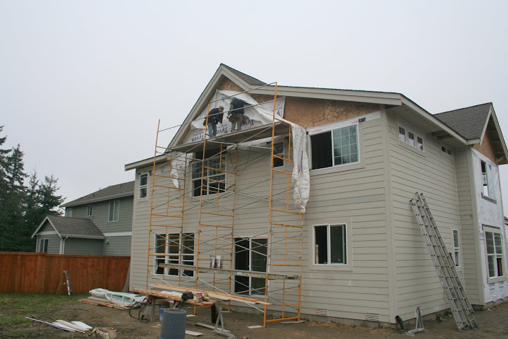

You know though that to set up pipe staging in that room with the "framer" in it, wouldn't take long but 30-60 min. It really wouldn't be bad at all. We set up pipe staging to side a house last winter and it took 3 guys about 30 minutes to set it up and we were up there aways. I think it was $50 or so.
I used to get up on ladders, ladder jacks and a plank. I think the highest I ever got was the plank at the topplate height of 3 stories (daylight basement). 30' is too high for me, and now 20' is too high to just be on a plank and ladder jacks.
