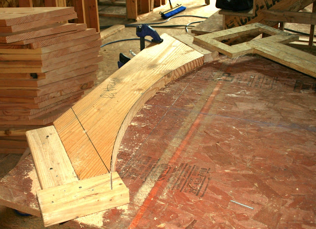

Radius Jig For Cutting 2x Rafters
I finally found out which project I'm on this season....There's sure to be a lot of progress pics to come!...But I'm going to start out with a question!!
It's going to be a great learning experience and a very cool project.
The pics Here are the rafter drawings and one of the elevations. (best I could do, sorry)
We'll have (don't quote me) some 150 odd rafters to cut with a radius....The Architect and foreman have the patterns figured out, but I'd like to know if any of you have a good jig or advice on how we can bang these out....so far the ideas are jig saw, portable band saw, or router.

Circ saw.
Seriously, we do a lot of curves, domes, arches etc, and if the curve is less than 5 ft radius, it cuts nice and is much faster than the jig saw.
Warren is online now

Yup, Warren and Framerman nailed it. Circular saw should do the trick. You could look into an Arcus blade too. They are made specifically for cutting arcs.

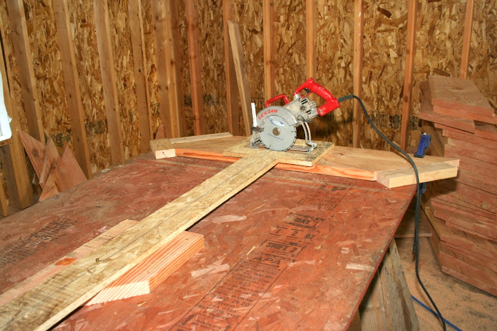

These were done with a Skilsaw.
Radius Jig For cutting 2x Rafters-010-3-.jpg   Radius Jig For cutting 2x Rafters-005.jpg
loneframer is offline

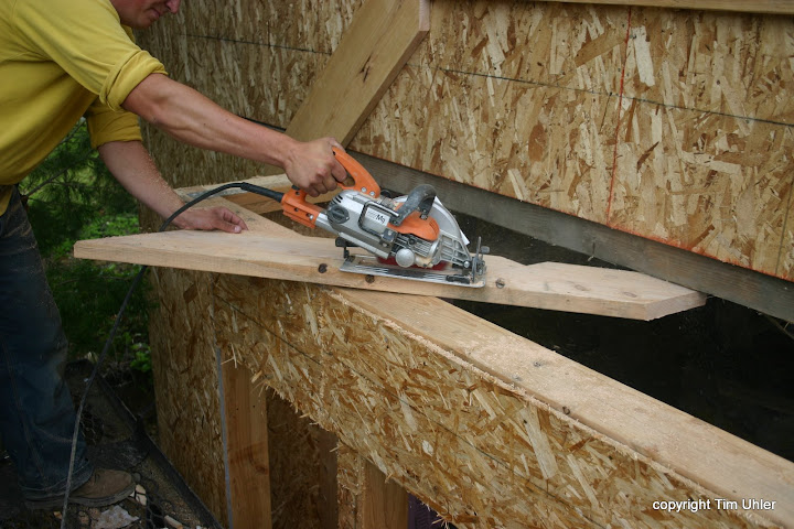

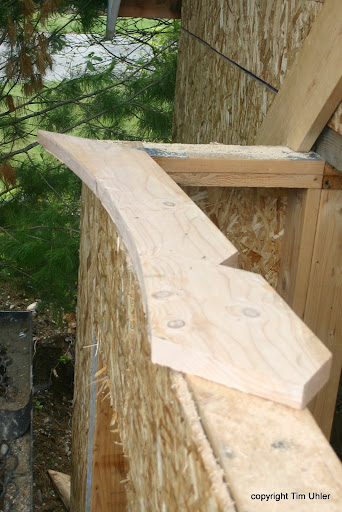

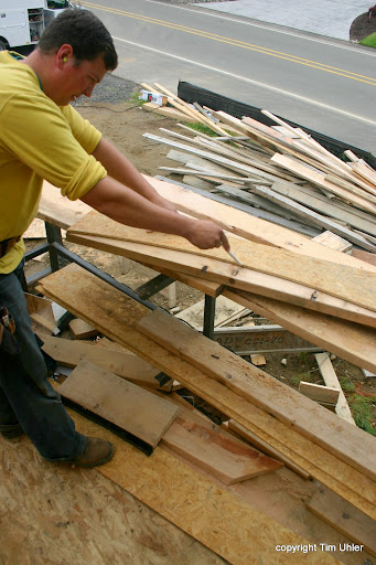

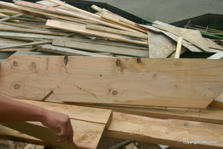

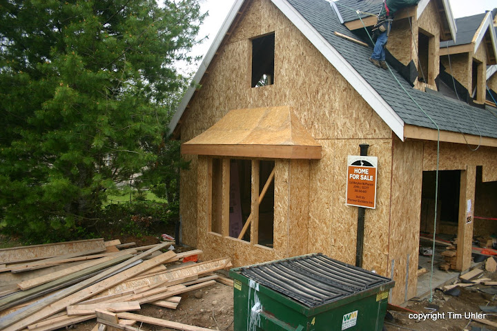

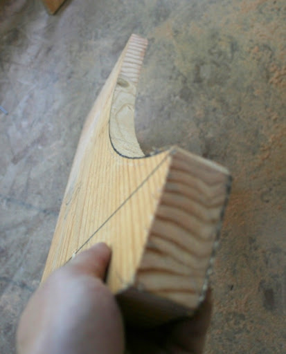

Get the Arcus blade for your saw. They make one for blade left and blade right. I have consistently cut a radius as small as 42" or so. I can't recall exactly now, but I cut them in one slowish pass through 2x12.
Make a pattern with a nice curve, then just freehand the cut.
Here are some pics I took while my old framing partner Matt did the work
Regular blade
