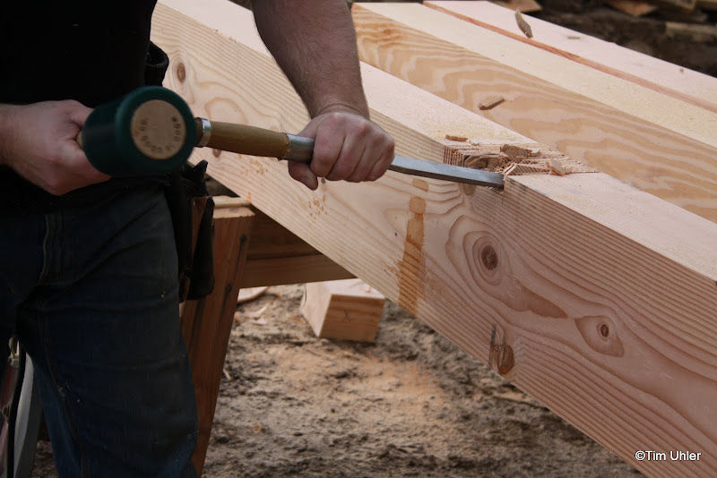

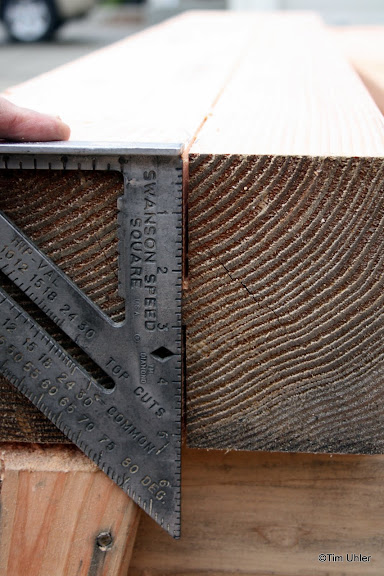

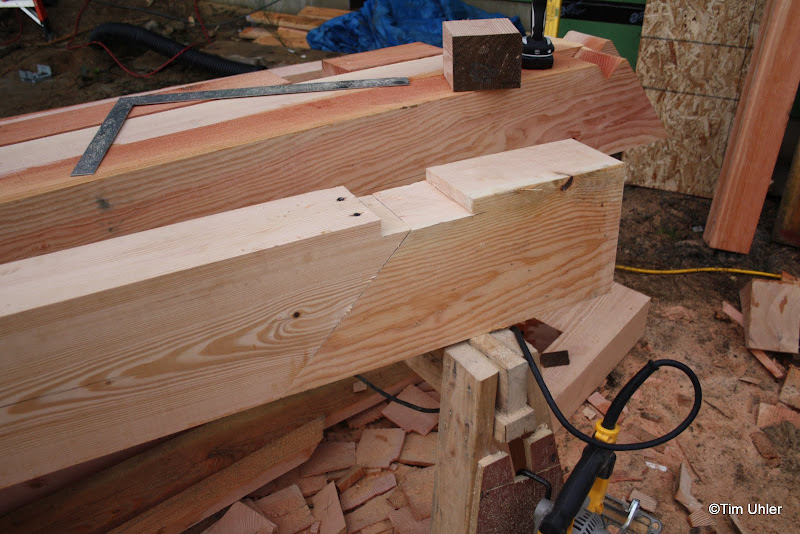

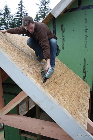

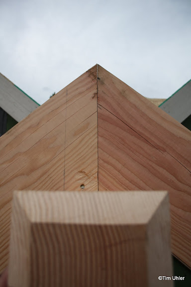

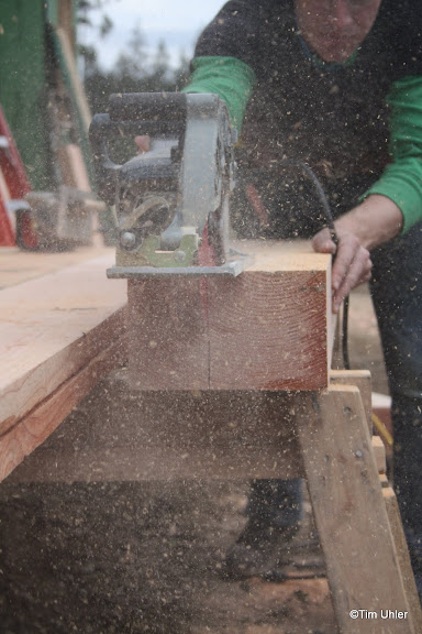

We finally got most of the work done. I've been way off my game on this roof and then week before last I was out with food poisoning. So yesterday we got our materials, all KD Doug Fir FOHC 6x10 and 6x6. A 12' 6x10 was about $130 vs green at about $40
I realized yesterday afternoon that I was short material for one strut, and I made a mistake that I had to compensate for. So it didn't turn out quite as well as I'd hoped, but it looks good for a framer (rough framer)
Pictures below

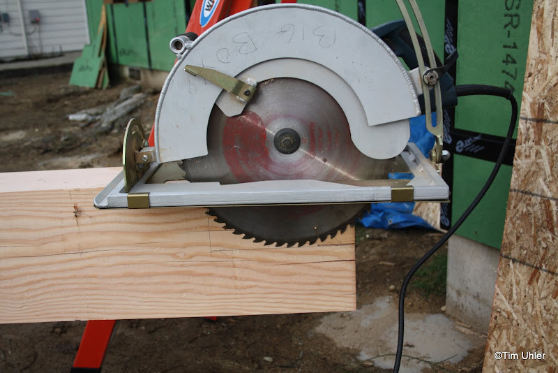

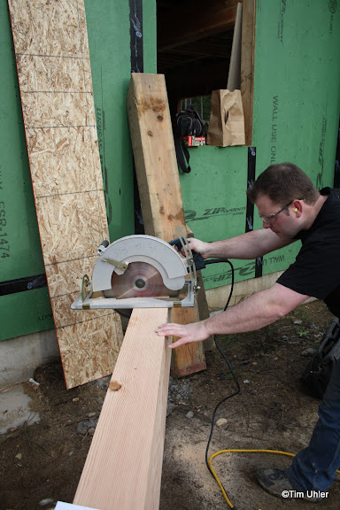

Got to use the 14" Big Boy quite a bit and it did well. I made most of my cuts first with a 7 1/4" saw, then used the Big Boy to minimize blade wobble
This is the 1" housing for the 6x6 kingpost and my 1" chisel.

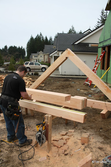

My plan was to set it up temp and scribe and fit the king post and struts, which worked well for the struts, but it collapsed before I got the kingpost cut.
1" housing for the struts.
Timuhler is offline

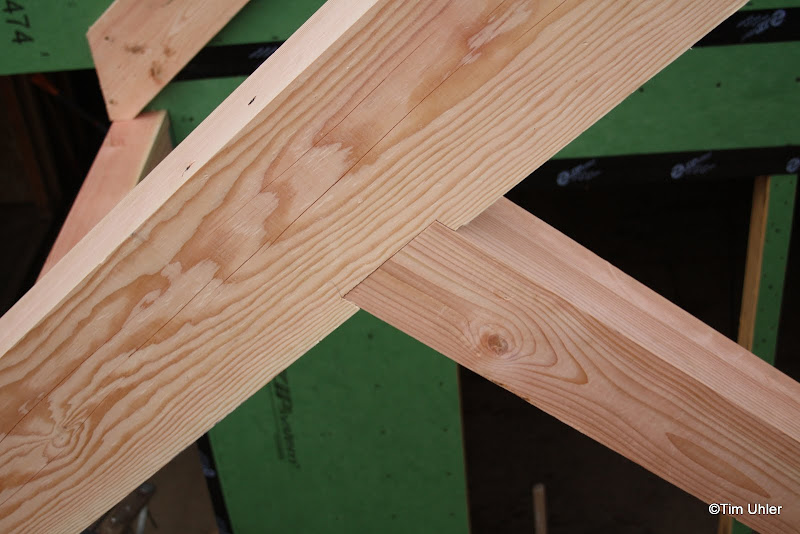

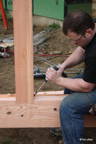

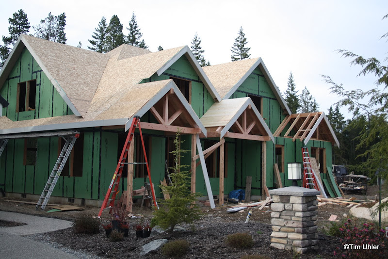

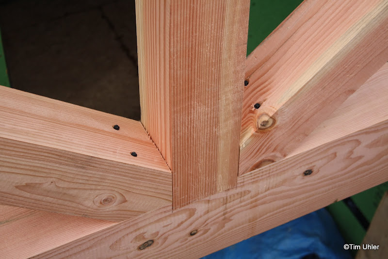

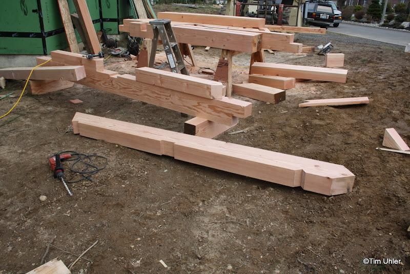

Old 03-02-2010, 08:20 PM   #31
Posts: 711
Re: Post & Beam Style Entry "Truss"

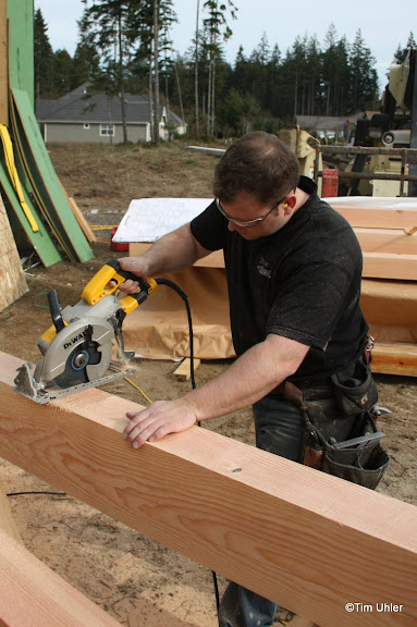

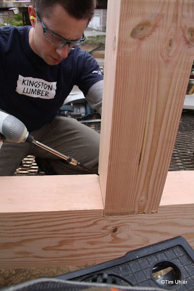

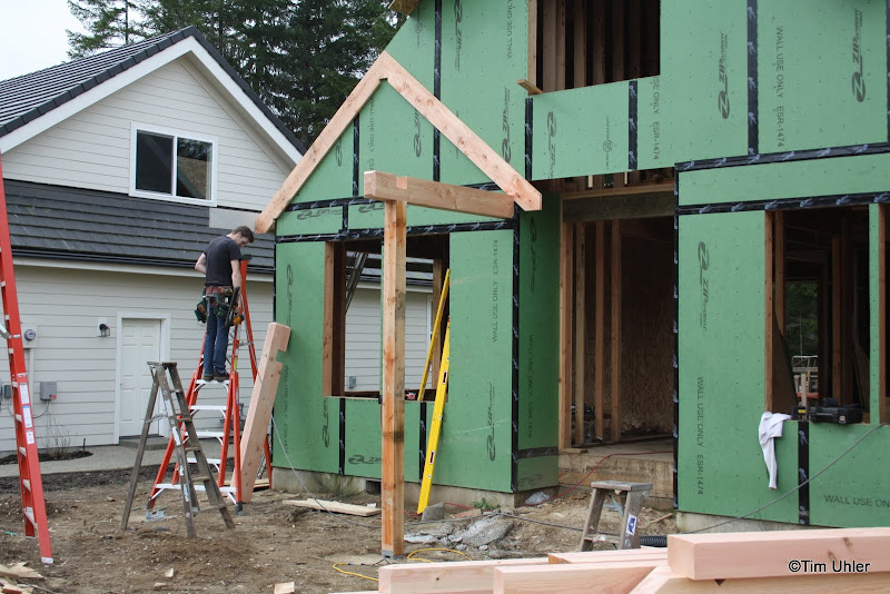

Most everything is cut at this point, so we started setting the pieces.
6x10 Rafter with the housing cut into it for the angled strut.

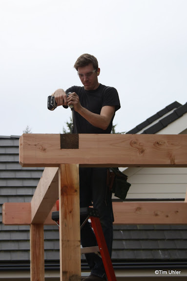

I cut the "bottom chord" to it would half lap the beams. Kyle is just screwing them together with long TimberLoks.
Bryan is using 6" TimberLoks to "toe scre" the king post into the bottom chord.
http://lh6.ggpht.com/_QGGH89KvQEY/S4...6/IMG_0547.JPG
oops

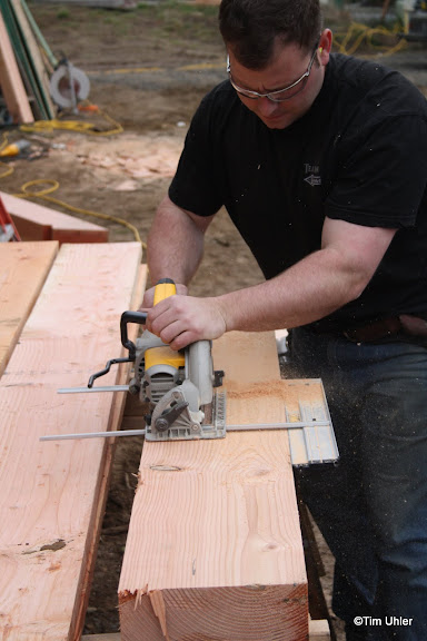

I was short enough 6x6 for one of the struts, so we used the new DeWalt Rip Guide to make a 6x6
Timuhler is offline

Hey Tim why did you notch all the way thru your beams? When we have to set our 6x beams on 6x post we notch into our beams about 2 inches to allow the bottom cord to bear on the post. This keeps the outer edge of the beams clean give you better bearing and most importantly keeps our 6x12 intact. I think you might have set yourself up for your bottom cords cracking at that notch. Could be wrong. Did that bottom cord only have to be cosmetic of is the ridge bearing on it?
Chris@Sunrise is offline
Old 03-03-2010, 09:17 AM   #35
Posts: 711

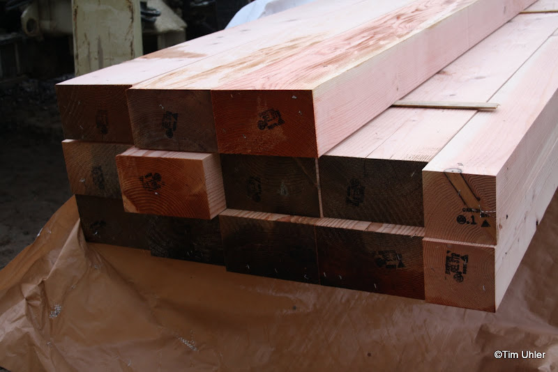

The whole thing is cosmetic, which gave me a lot of latitude on design and cutting. I talked to our engineer and he said don't worry about it (I had sent him the drawings).
I notched them this way so that the "bottom chord" would half lap the side beams (rafter plates/beams). I just split it evenly between the two and sat them on a 6x6 that will get framed out for a tapered column later.
I am not an expert on any of this, but did post drawings early in this thread and got some feedback on the half lap. I did learn a lot as I went through this. One thing is that I need to sharpen my chisel, it is pretty sharp, but I want it to be sharper.
Another thing is that if at all possible, I want to preassemble it all on the ground first and then lift it all in. That doesn't always work if the rafters bear on the ridge, but I can make it work. We were just way short on time on this one, but all in all I think it turned out well.
Timuhler is offline

Thats a nice project, a nice job by you and nice stock. The lumber is crisp it looks like you belt sanded all surfaces and connections.

Thanks. The lumber is good looking thats for sure. I didn't belt sand any of it and to be honest, I only knifed a few of the cuts before I made the cuts. I was in a bit of a hurry on this one.
