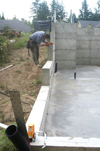

I am curious as to learn all methods for ensuring the walkout walls are square to the foundation when framing a new house. Today we started a new house and this time we plumbed a stud at each corner (only 2 on the walkout section) and pulled diagonals from a rectangle that we created. I think this is generally a accurate method but still leaves some room for error. What do you do?

i always set up batter boards 5 feet from hole perimeter....
plank and plumbob from intersecting lines to pin with a 16 inch peg on corners
then check after footings are poured and lay your walls off the pegs

this is what i was talking about .... im sure everyones done it this way ....

The PLS90e is insanely accurate and fast. I sent it back east to Greg Di and he used to to square a multi-level deck. It sends out 2 vertical lines square to each other. So you can mark each step down and connect the dots.
Here are a few pictures
http://picasaweb.google.com/TimothyU...eat=directlink
