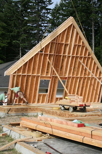

I would have framed on the ground and sheathed while standing. Or used my truck winch and a pulley in the tree to stand it (don't tell L&I)

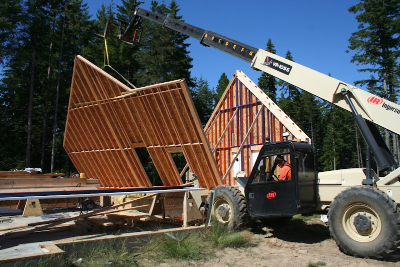

A year ago last August we hired a crane to lift a gable wall. We have lifted the same wall (same plan) on other sites with our forklift, but couldn't get in there with this one. Its possible we could have, but I don't like to drive the machine with the boom straight up. It was about $400 total, but saves a lot of time adding the flyrafters, Tyvek, overhangs, and then it is easier to set the ridge later.
If I could, I would build as many huge walls as I could, then have the crane come out and lift them all. Even if I had to frame them on top of each other.
Same basic plan, but we used the machine to lift the walls
