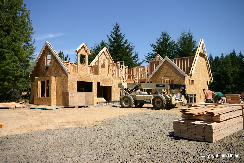

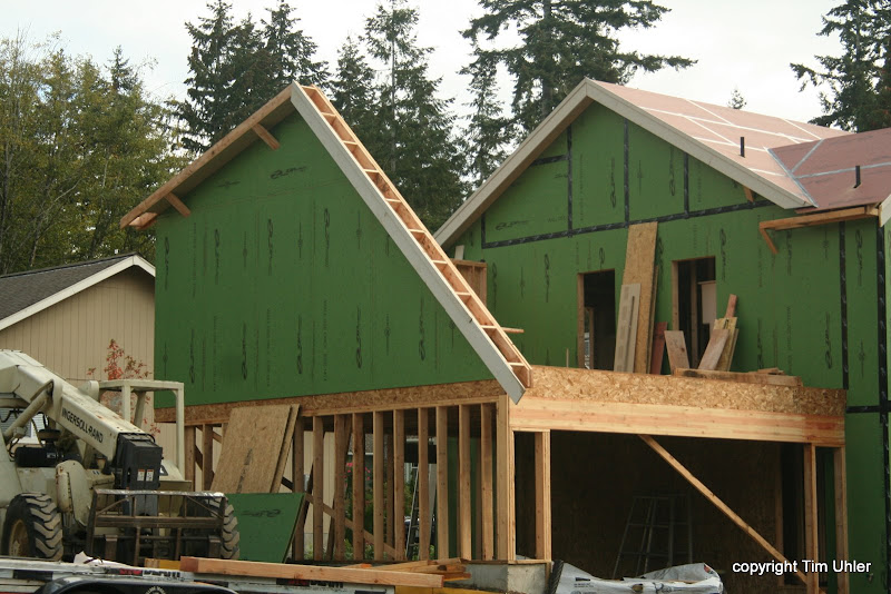

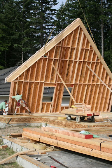

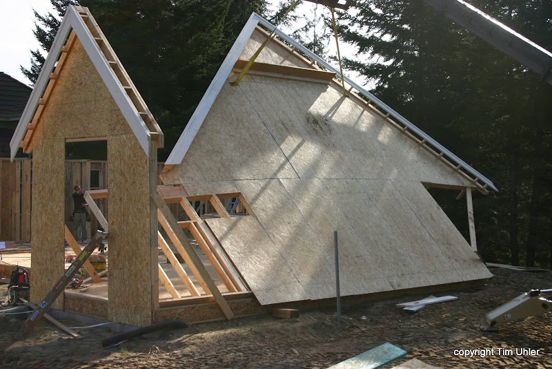

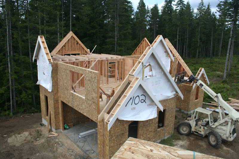

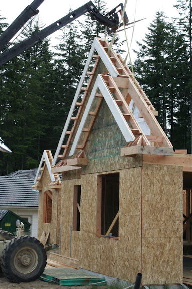

A lot in the posts to reply to, so I'll probably miss a few.
Regarding the need to make things perfect, and taking a gamble. A rakewall isn't really different in principle than an other wall that is squared and sheathed on the ground.
First off, the math doesn't lie. So if I have a wall that is standard height, say 92 5/8" studs, then my wall is 97 1/4" (years of using precuts will tell you that).
Ok, so I know my heelstand (HAP) before I start framing because I do So should anyone hand cutting a roof or trussing. So I can measure up at the corners square whatever that is, say 10".
Now, I calculate my rafter lengths off the length I cut my plate, which is cut to the lines on the floor. The lines on the floor are dead square and parallel. How do I know they are perfect? Because I snap them that way. I either use my calculator or the laser to establish perfectly square (unless the wind blows the laser line )
So if for instance my rafter length is 15' exactly (I dont account for the ridge. I tack a nail at my 10" marks and swing two arcs 15'. This automatically locates the center of the gable. I snap that line and then one 3" lower for 2 topplates and start framing. Oh and if the deck is dry enough I snap the center through and the kings.
I locate my ridge post working backwards from the peak.
This is not rocket science. As far as I'm concerned for the wall, I need to know 4 things 1) the span 2) my wall heights and 3) my heelstand (HAP) 4) slope or pitch of the roof.
I didn't snap the goofy wall with the 12-12 and 4-12 starting from different heightsr, I used the math and the rafters to locate it.
I can post quite a few pictures going back quite a few years that show I'm not gambling, they were right and worked. I've got an idiot proof method now that goes pretty fast. I stole the overhang detail from east coast guys who posted over at Breaktime and we haven't looked back since (we started putting the overhangs on in 2006)

From my understanding Tim you build your rakewalls so that the top plate is the top of the rafter but your saying it works the same way if you build your rakewalls to the bottom of the rafter and stick your ladder on the top plate? And your saying you don't cantilever back into the rafters because the overhangs you frame are short and you find now need too. And finally your saying that if you build it your way and nail the ladder to the side or my way and nail the ladder to the plate as long as the overhang is not to long,you nail it well and if it is held by the subfascia it will not shear off the wall and sag...when i say sag i don't mean sagging over the span of the rafter but actually sagging off the wall.
I know you have explained this many times but I just want to be 100% sure so that i can use better methods when I frame my sheds :p

Posts: 12,829
Re: Gable Studs
Originally Posted by FramingPro View Post
Im 13
You're hired, as soon as you can legally pick up a power tool.
