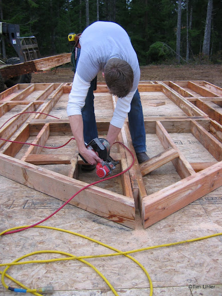

FramingPro,
Take a really close look at the pictures posted here or go to my site. I'm a little short on time, but I think the pictures and captions explain it well enough.
When the roof sheathing is nailed to the gable assembly and flyrafter and the overhang is only 12", it isn't going to sag. Plus it is nailed to the fascia and subfascia.
I put the "soffit" ply on before we lift because that helps keep the gable wall straight. I use LP 12" unvented soffit 16' long. As you can see in the video I posted, that wall stayed nice and stiff being raised.
The braces I was talking about are either 2x4 or x6 with 45 beveled on each end that brace the gable assembly square to the wall.
Timuhler is offline

Originally Posted by FramingPro View Post
wow feels good to be back..I got banned for a week so what my question really was, doesn't moment shear the whole ladder assembly off the wall? And also do you do build the gable wall so the top plate is underneath the sheathing so that it eliminates the hingepoint that you get if you build the wall to the underside of the rafter and then build you ladder to support your overhang
I'll get to it a little later. If you look at the pictures and the video, I think you'll have it figured out.

Tim you have any finished framing pics of this job, before sheathing.
I don’t understand the sheathing first method and how the ridge ties into the gable.
Not mocking, just we don’t do that kind of framing around here.
What’s the pro’s and con’s doing it this way?
Looks like he leaves a pocket where the ridge ties in. In the second to last pic where they are raising the wall you can see a pocket at the top inside the triple....

the 2x4 nailer needs to be cut back

That job in in process, so I'll get some shots today. We kept forgetting to cut that topplate back. But there is a pocket there for the size of the ridge. The ridge will sit in there and then we can nail through the topplates and and the studs on either side.

You’re pretty confident that the common rafters will plane correctly.
The building would have to be perfectly square, parallel and the wall heights all must be dead on.
Not to mention the rafters must be cut perfect too. I do not doubt your skills here. I have built some complex roof system in my years and experience tells me you’re taking a gamble.
Even with structural engineered floor beams there is always a height difference that will cause your overall rafter height to change.
I look at it this way: one corner is down 1/8” and the other corner is up 1/8” you will have a Ľ” difference which directly affects “total rafter height” and how each side would plane.
