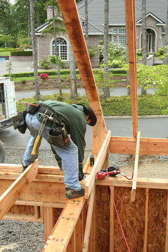

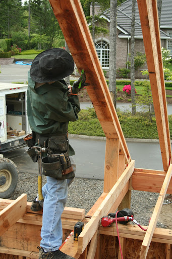

My outside rafters get a plate nailed flat to the bottom before I even send them up to be installed. I can also layout the plate with the long point to line up stacked with the studs below.
Then I cut all the gable studs with my SCMS and send them up. One bevel cut...
I was taught the way you speak back in 1989 when I was a rookie. Sometimes we would even start the outside rafter in from the outer edge by the thickness of the stud (3 1/2" or 5 1/2") and cut the gable studs square to the short point length. Then we would face nail the rafter into the studs. I will try and find pix of all three ways.
When I became the boss - I reexamined everything and explored all the "why do it this way" questions I had.

so how do you do your outlookers in those pictures then?

Cut them in flat - no snow load in the deep south

Here's one done both ways on the same house
Mostly on gable walls I try to build rake walls....if it is at all possible at least.
