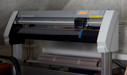

It's right up your alley Gus! It's essentially a mini cnc with a knife cutter.
10 mil mylar is the medium. $72 for a 30" x 150' roll (375 SF)
Simple CAD lines on screen, press "print" and it cuts aaaany shape you need.
Zip, zip, zip.....
I can make a 100' x 100' template if I need one. There is no limit.
I can even make those doily things that women use to put borders at the ceiling line.
Much easier is to get a graphics print shop to do it for you for about $1/SF
Precision is beyond anything I can do. Hundredth of an inch.
I'm trying to figure out how I can attach a router head to it

The issue with what I have is that it is just a template so you have to free hand it after.
Leo's is more precise to machine out.
Mine is more flexible in the shapes it can make.
Plus you don't need the equipment. Just your local truck sign graphics shop. They have this equipment right in his shop. Maybe minus the Mylar, but they have other material. It's interesting to me, but probably a yawner for everyone else
