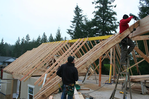

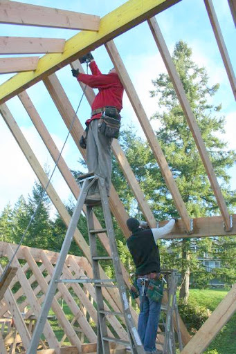

Hold the rafters 1" tall and then sheathe 1" past and this will leave airflow for the ridge vent
sorry for the huge size, but you can see the ridge was a tripled 2x12 so we held the rafters 1" high (lowered the ridge 1")

The most important part of this detail after you allow for the air is make sure that over shot seathing is rugged enough to nail the ridge cap I often will make little 2x triangles to go on top of the lvl to make the seathing more ridged

dos mas

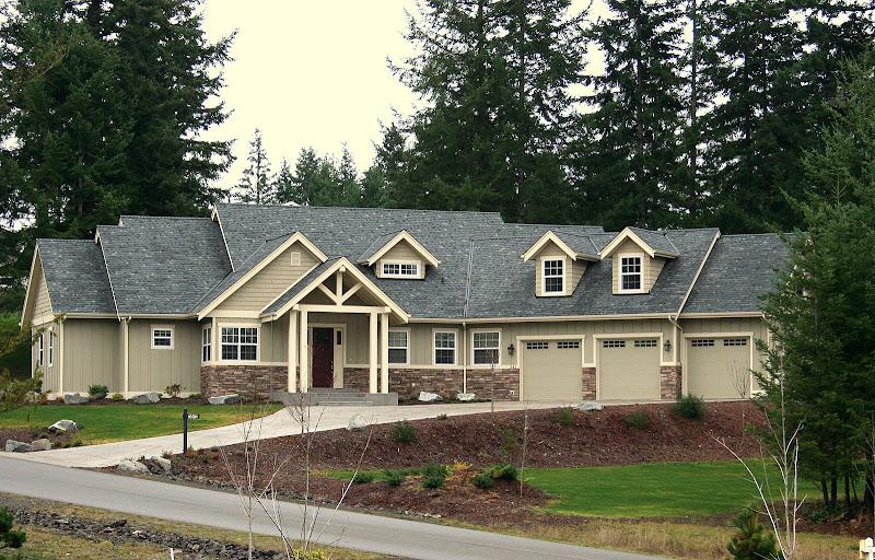

Tim, is that siding in the last picture? It almost looks like gyp board.

It was 4x10 LP Smart Side non grooved. We added 1x3 batts later to make it board and batten. That was one of my favorite houses to frame.
