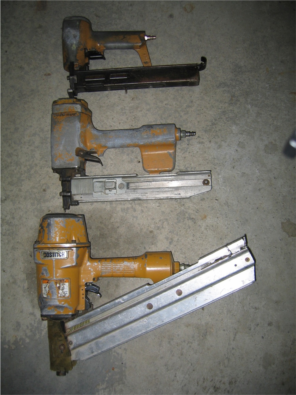

Old 10-01-2009, 10:17 PM   #17
Kgmz's Avatar
Posts: 1,264
Re: Best 7/16 Crown Stapler
Pic of old Bostitch guns.
T35
T36
N80
Kgmz is online now
