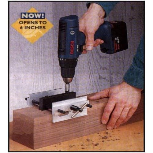

Hey, guys. I've got a production job coming into the shop, and I want to use wood dowels on it, but we're not set up for that...we do primarily cabinets and countertops, mostly plast. lam. Can anyone recommend a small, portable dowel drilling set-up, that will allow me to ensure precise spacing between my dowel holes? I'm hoping to get by with only spending a few hundred dollars. I'm going to have to install just four dowels in each of 5,000 assemblies, so I'm not looking for a heavy industrial machine. Thanks in advance, to anyone that can point me toward a manufacturer of something like this.

Thanks! I think that's something I could jig up pretty easily.

Haven't used a self-centering doweling jig in years, - - seems like there's so many other options these days, - - and although these jigs are highly accurate, - - they're somewhat on the slow side, - - especially if you're discussing production-type jobs. But they do have their uses for certain applications. I should have at least 3 of them (old ones, at that) laying around in some cabinet in my shop somewhere. What kind of application are you using them for, Doc2626?? Maybe we can figure out a quicker method for you, - - or at least throw a few dumb ideas out there, - - just enough for you to come up with a better one off one of 'em . . .

Not sure where you are drilling the holes, how far apart, etc. Here's a pic of a jig, but it's for two holes (just add holes for four). If you are doing "four dowels in each of 5,000 assemblies", 20,000 holes, I'd make a jig similar to the picture out of steel or aluminum bar(flat) stock or hardwood with bushings, it won't cost a lot and will really increase speed and accuracy. You better have a lot of drill bits.

Yeah, - - actually, - - a drill press and stops seems the way to go, - - but I guess he doesn't have one?? Good time to spring for it.
Still like to hear his exact application, though . . .
