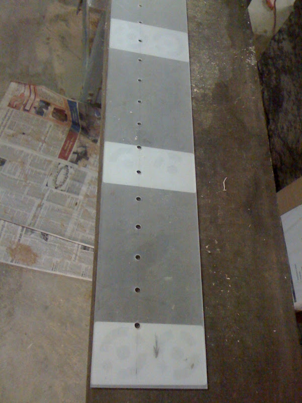

Looking for ideas on what everyone uses for drilling adjustable shelf holes in bookcases, cabinets and other items where adjustable shelves are used. I currently use a Rockler JIG IT Shelving Jig. It works great for small cabinets, but difficult to maintain spacing when drilling a tall cabinet. Let me know, what you have found or have built that works for your jobs.

I just use a plywood strip with holes in it. I have several of them of different lengths.

Blackte, I use the Rockler jig on all of my cabinets now no mater how tall. You just have to move the jig and use the pin in the spacing hole. The key I think is to clamp the jig down to the piece each time you move it to keep it from shifting. If you have problems with the jig just cut a piece of hard board peg board the height of your cabinet and use the holes as your guide. Just make sure you put it in the same orientation top to bottom on both sides of the cabinet.

Rocky, thanks for the info on using a clamp with my rockler jig, and also using peg board as a template for checking the holes. I just did a large walled unit, and some of the holes got off, and had to explain to the homeowner what happened. I'm guessing it was a combination of me holding the template and trying to drill all at once. I did find a nice unit Veritas Shelf-Drilling Jig, but it's a little pricey, but looks really well made.

Take a look at the festool router with the LR 32 guide rail. It gives you a guide and indents that the router will stop in to correctly space the holes

In a bind, I made a jig out of 1/8" (I believe) plexiglass or Lexan, can't recall. I made the holes on the drill press and now I have el cheapo hole drilling jig.

On the few that I have had to do, I use a section of pegboard. Works out great and is basically disposable b/c of the low cost.

Pegboard and the forstner bit...

My guy uses something like this.
